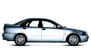

乖宝 - 2003/12/31 2:41:00
附件: S40_1_main_ex.jpg

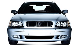

附件: S40_2_main_ex.jpg

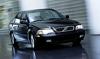

乖宝 - 2003/12/31 2:42:00
附件: S40_3_main_ex.jpg
